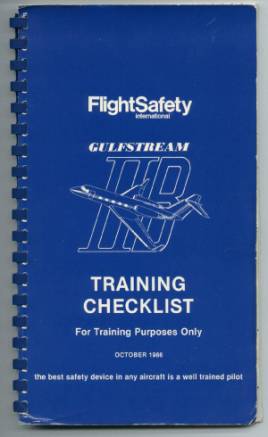

Typical Corporate Jet “Hard Copy” Checklist
(Flight Safety, International)
Checklists are used for two different purposes. One purpose is to set-up or configure a system (even the whole airplane) while the other purpose is to ensure that a failure of a system is corrected. There are four basic methods used with checklist design (Orlady p.159). They are the “read, do, and verify”, “do, challenge, and verify”, “”do and verify”, and lastly the “combination where the “do and verify” checklists are used in “non-normal or emergency checklists in conjunction with immediate action items, which must be memorized” (Orlady p.160).
Checklists must be designed for a particular action within the requirements of the number of pilots who are available and the specific equipment evolved. For example, the pilot of a single engine propeller aircraft will have to make do with the “read, do, and verify checklist” simply because there is not any other crewmember to challenge or assist him. On the other hand, aircraft with three crewmembers (two pilots and a flight engineer) have the luxury of more flexibility in what types of checklists are used and when. An important point to consider is that any checklist must be designed for a particular action to occur based on that particular type of aircraft. For example, multi-crewed airliners like the DC-9, MD-80/90 or Boeing 717 need to have their own particular checklists based on their models even though they are updates of the same basic types. Airline management cannot use a blanket checklist procedure to cover the different changes of models within types within their fleets.

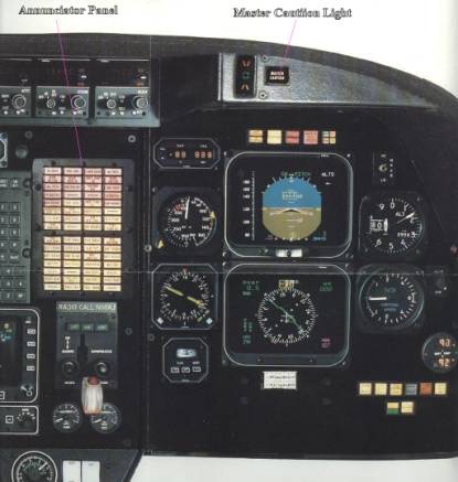

When an abnormal (or emergency) situation takes place, detection is first noted by the activation of the pilot’s senses (vision, auditory, touch smell). Two of these senses, vision and auditory, are the primary indicators of the requirements for checklist action. Usually, the first indication of an abnormal or emergency condition is when the Master Caution Light is illuminated or a circuit breaker pops. After the initial indication, the pilot’s vision will be the primary factor for corrective action. What the crew sees (or has to see) will determine the outcome.
Right side instrument panel of an Astra 1125 Corporate Jet
The light’s “push
to test” switch has been activated
(Flight Safety,
International)

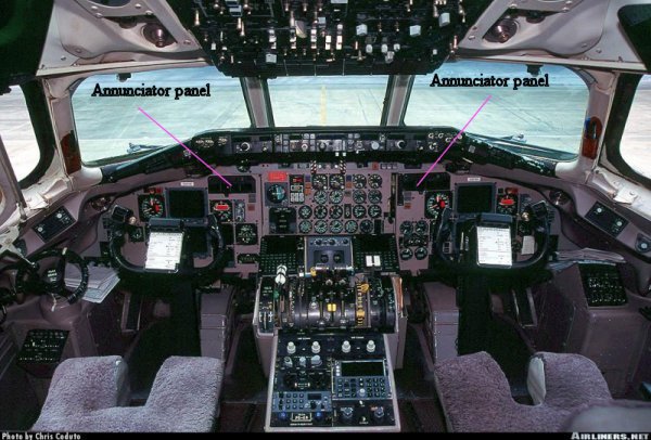

Usually, the first indication of a problem is the illumination of the Master Caution light followed by one or more items appearing on the Annunciator panel. The panel shown (in the above illustration) is a trade off between space and placement of the one single annunciator panel. While the First Officer has direct eye level contact with the Master Caution light and Annunciator panel, the Captain has to look over to his right for his view of the Annunciator panel. The illustration below (panel of an MD-90) shows that both the Captain and the First Officer have a direct view of the Master Caution lights and the Annunciator panels.
MD-90 Cockpit
showing the location of both Annunciator panels
(The Boeing
Company)

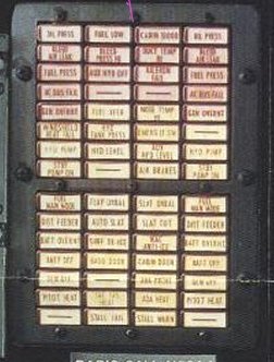

In the example of the Astra 1125 Corporate jet, the Master Caution light has a one-color design. It will illuminate in a white hue no matter what the indicating cause from the Annunciator panel. The Annunciator panel has a two-color design. Red hue is used for emergency items while a yellow hue is used for abnormal developments.
Master Caution light (white hue only)
in “Push to Test” mode
Annunciator panel, color-coded to Emergency (Red) or Abnormal
Conditions (Yellow). Panel shown is in “push to test” mode with all lights working.
(Flight Safety
International)

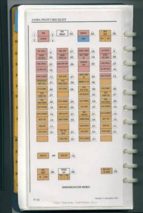

The Emergency or Abnormal checklist process begins with the illumination of the Master Caution light (to attract the crew’s attention) followed by one or more lights appearing in the Anunciator panel. The crew will deactivate the Master Caution light (usually by pushing the light switch in) and reach for their checklists. The checklist process continues as the crew will decide what item (or items) applies to the specific condition. Speed and accuracy is of the up most importance. The illustration (next page) is of a Flight Safety Checklist that shows the same layout as the Annunciator panel.
Flight Safety
Checklist opened to show the Annunciator panel with page numbers to the right
of each light corresponding to the Tab data (on far left).
(Flight Safety,
International)
Once the light on the Annunciator panel and the same light (color coded) on the checklist are verified you can view the page numbers of the items (to the right of the checklist’s Anunciator panel) and then open to the corrective actions on the checklist indexes. The index numbers are printed on both sides of the tabs to aid in location. Flight Safety, Inc. certainly used a human factor’s approach to this design. The only improvements I could suggest is to color code the red emergency tab data on the sides of the pages (shown above) to red tabs (not orange). A good question is why use any red hues in cockpits. The answer is that at night in an emergency or abnormal condition, the pilots will turn on the overhead floodlights that are white in color. A red hue, at night, is not a safety factor in multi-crewed airliners.

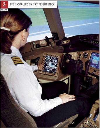

If we are to use electronic checklists and displays, we must place them in a position so that airline crews will be able to see them at critical times. The quote below details this best.
“Focal vision is the central 30 degree of the visual field. This is the area that people use to look at object in the world, moving their eyes as needed to bring images of the object on to the fovea, which is the area of highest acuity. When an object is outside of the focal area, a person will usually turn the head rather than simply move the eyes. By locating frequently used displays in the central 30 degrees of visual field, the user is not required to move his or her head to bring the information into the focal area”. (Source: MIL-STD-1472F, 1999)
Another important question is, can we position electronic checklists at a place in the cockpit where all flight crews will be able to see them? With a hard copy checklist, it is possible to adjust the distances and viewing angles that will work best for the age and optic abilities of the pilots. The quote below best illustrates this situation.
“Users have individual differences in their preferred viewing distances. It is preferable for users to adjust the viewing distance to their preferred distance”. (Source; Jaschinski, Heuer, & Kylian, 1998)
Electronic “Flight Bag” containing checklists, approach plates, etc.
(The Boeing Company)
There has been extensive research data on the role of automation and the future of electronic checklists. In my research, the best study (that I found) is the one done by Palmer and Degani who ran three human factor’s tests on how different types of checklists performed when given a set task to accomplish. Of the three types of checklists studied, the printed checklist resulted in fewer errors than any of the other electronic checklists (Palmer, Degani, Web). In my opinion, all electronic checklists have a basic built in fault. From a human factor’s standpoint, electronic checklists require two human motor skills that must be done together. To effectively use electronic checklists, you must have both a visual scan on the data items and use motor control dexterity by physically scrolling down the menus. In a real emergency, this might place an excessive workload on the crew, at a critical time of flight.
Does this means that I am against automation in the cockpit? My answer to this is that automation has a definite place in modern day cockpits. One of my main concerns, of any checklist, is that flight crews can get overwhelmed with extensive manual details and not have time to “sort things out” in regards to the abnormal or emergency items. For example, the condition of “smoke and fire of unknown origin” is a detailed task to quickly rectify using any type of checklist. This condition may require the use of detailed schematics and several steps to go through. The real answer to this problem is to have built in automation to solve problems like this, and shut down the failed system automatically without any crew impute.

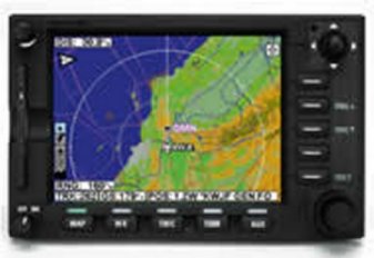

Another area of concern with electronic checklists is the resolution of the current displays and the ability to see the screens in a bright light condition. These faults can be developed, but I believe the paper checklist will be with us for some time. I would like to see airline management concentrate their human factor’s efforts, in designing workable, color-coded paper checklist (like the Flight Safety design shown in this paper) that out performs any other types of currently available electronic checklists.
There is another area concerning checklists that I would like to see developed. The Intergraded Hazard Warning System (IHWS) has the potential to place another “pilot” in the cockpit. This system has the possibility to have a human voice, that is electronically always there (in the background much like GPWS), to avoid pilot errors when performing checklist items. For example, the “Emergency Engine Shutdown” checklist has the potential for pilots to shut down the wrong engine. Airline procedure is to have the Captain ‘guard’ the good engine while the corrective action is accomplished by the First Officer. While this implies good crew coordination, it does require the Captain to direct his attention away from flying the airliner to take part in this checklist procedure. With IHWS, it is possible to put a third “pilot” into the loop who could help with checklist compliance. My position is to let the Captain fly the airliner (first and foremost) and (in this example) if the First Officer happened to move the wrong throttle, IHWS would call out something like “Verify Engine” or words to that effect.
